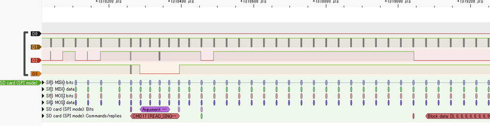

The analysis results from the logic analyzer are shown in the following image, and a response to CMD17 has been received.

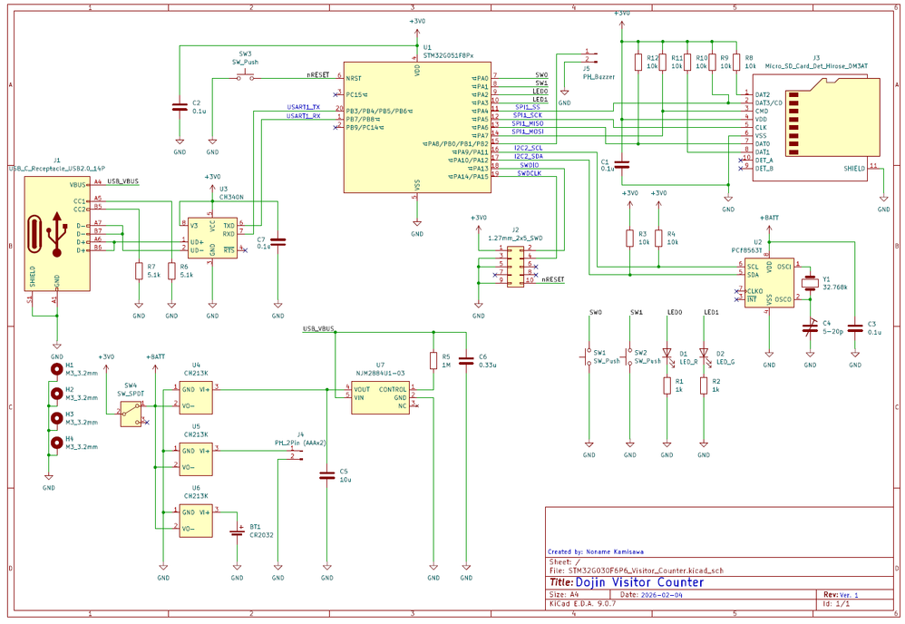

The pin assignments and SPI settings are as shown in the diagram.
The circuit being debugged is as shown in the diagram, and all signal lines on the MicroSD card except SCK (including DAT2 and DAT3, which are not used in SPI mode) are pulled up with 10kΩ resistors.

The schematics look reasonable, and 4MHz SPI clock should not be a problem, assuming the PCB traces are not too long. And since the SPI signals are associated, the PCB traces should have about the same length and characteristic impedance. At 4MHz, series resistors are probably not necessary - although I'm no hardware guy.
