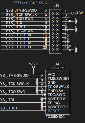

- Board setup used during recovery attempts:
- tried altering Boot0 (boot from RSS/system flash)
- tried manual reset
- tried low SWD speed and hardware reset modes

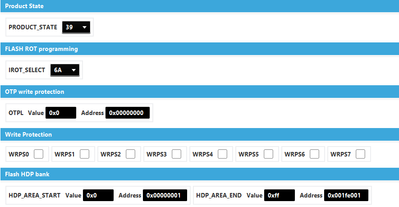

I was attempting to recover the board after secure configuration experiments. The board was originally reachable over SWD, but after running the **`ROT_Provisioning/DA/provisioning.sh`** flow from the STM32CubeH7RS package, normal SWD access stopped working. The board is now in **CLOSED** state, and **Debug Authentication Discovery** can occasionally succeed if I hit a very narrow timing window at power-up, but any DA action command (including **Full Regression**) fails.
I really would like to get the board back into 'Open' state by running a regression.

I have two st-link headers available on my board (I only plug the st-link into one of the headers):
Here is where the JTRST line connects to the processor:
Are you saying that nRST also needs to be connected to the ST-LINK SYS_JTRST?

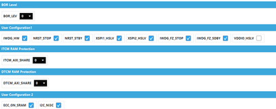

Additionally, even with the device back in 'Open' I am not able to perform an erase in Cube Programmer. I always get the error: "Mass erase operation failed.Please verify flash protection." Do you know how I can perform a mass erase? In Cube I have the following external loader set:
None of the WRP option bytes that are visible in Cube Programmer are set:
Thanks again!

According to the trace, you are using a STLinkV3 set.
According to UM2448 : "STLINK V3SET does not manage the JTAG TRST signal"
So, you should just connect STLink's T_NRST to the NRST of the STM32H7S
About option bytes the whole flash is set in write protection.
You should set all WRPx bits to remove this protection and it should work again.
