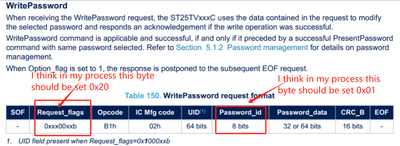

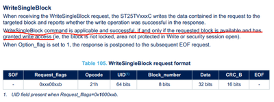

Based on the underlined sentence in the image, I first send the data related to the PresentPassword request format.
The corresponding configuration bits in the code are as follows

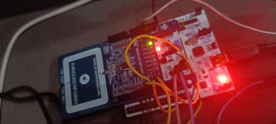

The device I used is shown here(NFC08A1+stm32f401)

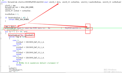

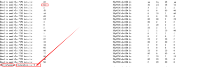

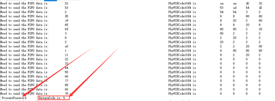

Next I try to print out the FIFO data as follows:
1.The GetRandomNumber function is normal
2.PresentPassword's ReturnCode is incorrect
3.WritePassword's ReturnCode is incorrect ,too.
so why is the value of ReturnCode 5?
And why am I still calling the api function of the demo? but invalid request or requested function can't be executed at the moment.
So, in order to encrypt the block, what exactly should I do? What configurations do I need to set up first?
Supplementary instruction,
my print function is as follows

Anyway, I guess PresentPassword returns an error code because the password has not been cover-coded with the random value. See §5.1.3 in the ST25TV02KC datasheet.
