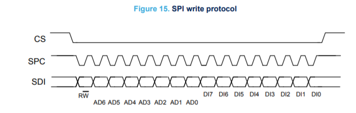

Hi Richiard @RHold.2 ,
There should be no reason you cannot write (but you can read) these specific two registers.
Did you configured correctly the SPI communication in writing mode (datasheet p.31)?
To investigate if the issue is related to the code, did you comment the line of the codes of CTRL1/2 registers, are you face issues with CTRL 3/4?
-Eleon
