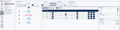

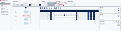

2. Next thing I notice is that when I load my FSM configuration and GUI files and click "Write FSM configuration to the sensor". Head to Sensor Evaluation and return back to Advanced features -> FSM. The FSM ODR now changes to 12.5 Hz.
This is how FSM tab looks when I load gui and config files but before writing config to sensor:
And this is how it looks after writing config to sensor, clicking Sensor Evaluation and returning to Advanced Features -> FSM
Why would the ODR change when leaving the FSM tab and returning back to it?

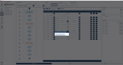

4. I was further playing around and testing with the FSM and came up with 3 FSM's. See attached FSM_crashing.zip
When I click "Write FSM configuration to the sensor" the application crashes and hangs on this screen:
Im sure I have misconfigured the FSM somehow but it would be nice if MEMS Studio would not crash/hang and instead tell me that something is wrong.

1-2) We identified a visualization issue which will be fixed in next release of MEMS Studio

4) The configuration generated was not processed properly, next MEMS Studio release will resolve this issue.
