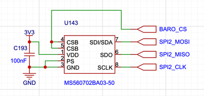

On this board i have two sensors connected to the same SPI interface (hspi2) with different CS pins to address the sensors. Here's the schematic sections of the two sensors :
MS5607 :

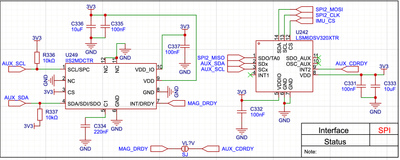

LSM6DSV320XTR with an auxiliary IIS2MDCTR tied directly to it (for the test board, the magnetometer is not soldered yet):
I'm currently on test phase, and the MS5607 is responding correctly. But the LSM6DSV320XTR does not respond at all. i'm not even getting the whoami ID (i get a 0).

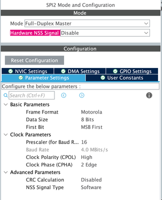

For the SPI configuration i have this :

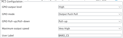

For the 2 Chip Select pins i have this config :
I don't understand where the problem comes from. Could someone help me asap ? I'm losing hope :(

Using MKI109D motherboard with STEVAL-MKI251A, the sensor communicate correctly using your SPI configuration (Baud Rate: 4MBits/s, CPOL: High, CPHA: 2Edge) and assuming IMU_CS configuration same of BARO_CS that you posted.
Debug tips:
Are you sure that SPI2 lines are connected to LSM6DSV320X? Do they move on its side when communicate with the other sensor (oscilloscope probing)?
Did you check on IMU_CS behavior (oscilloscope probing)?
