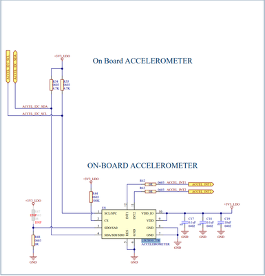

We are currently working with the LIS2HH12TR accelerometer on our Smarttrak board, using an STM32U575VIT6Q as the main MCU, and are facing an issue with unstable sensor readings.

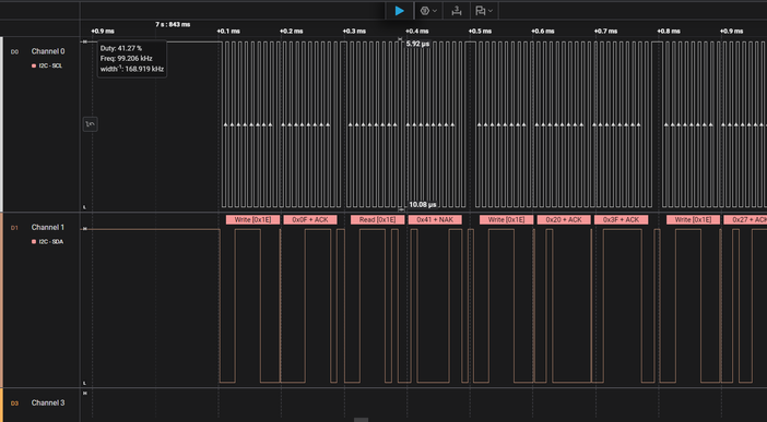

Communication appears to be functioning correctly, we verified the I2C clock waveform and confirmed that the bus is operating at 100 kHz. The accelerometer responds properly, and we are able to read data successfully. However, the measured values are not stable.

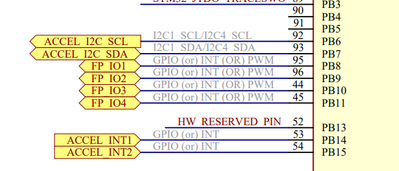

  • Could this be related to I2C timing, noise, grounding, PCB layout, or sensor configuration?
  • Are there specific STM32 side precautions or best practices for reliable accelerometer data acquisition with the LIS2HH12TR?
