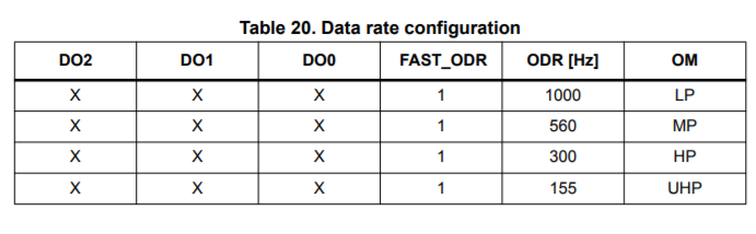

Consider that the maximum ODR in fast mode for the LIS3MDL is defined in the table below:
So, the max ODR in LP mode is 1kHz, and the maximum sampling frequency is 500Hz.
There is one other solution in ST magnetometer portfolio (LIS2MDL and LSM303AGR), but they run both at lower ODRs.
