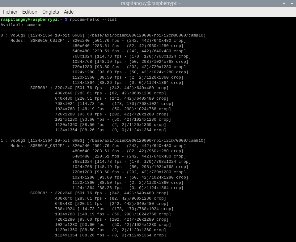

I am trying to capture video streams from two VD66GY cameras connected to the CSI0 and CSI1 ports of a Compute Module 5 IO Board. My OS is : Linux raspberrypi 6.12.75+rpt-rpi-2712 #1 SMP PREEMPT Debian 1:6.12.75-1+rpt1~bookworm (2026-03-11) aarch64 GNU/Linux
Both seem to be recognized:

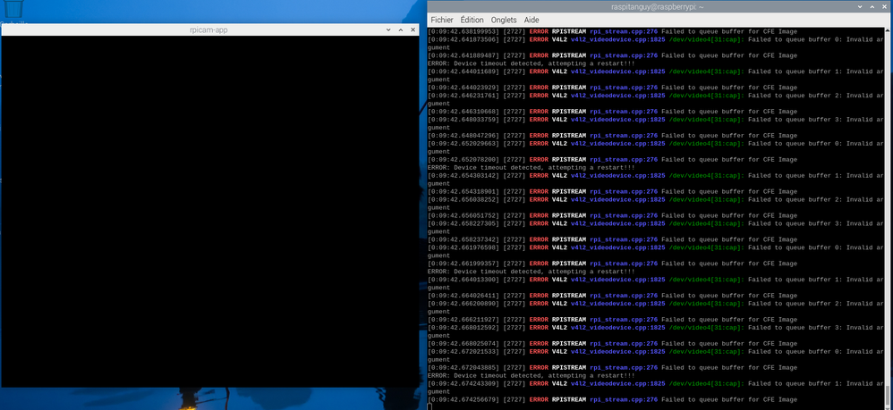

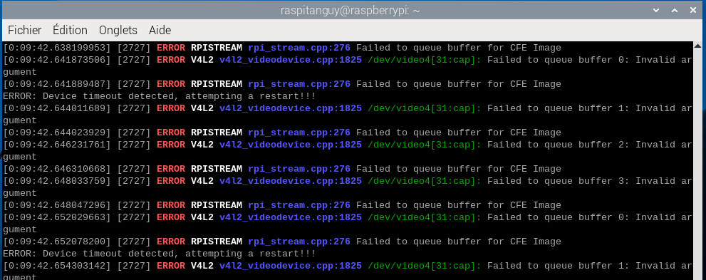

However, when I try to capture video from both cameras simultaneously, only the CSI0 port works. The CSI1 port returns the following error with this command ( rpicam-hello --camera 1):
I also tried a GStreamer command, but it didn't make any difference.

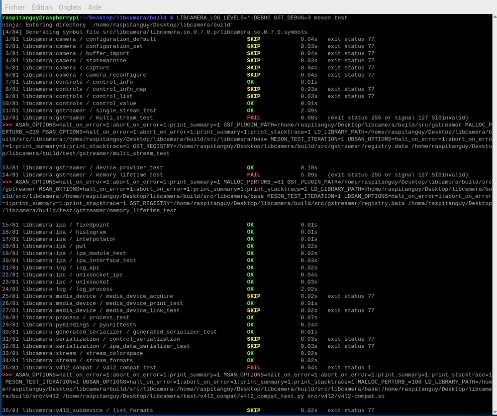

I carried out tests with only one camera connected on CSI1 of the dev board and I get the following results:
Note that I repeated the tests, but this time on CSI0, and the error related to memory_lifetime_test no longer appears.
Here is an excerpt from the kernel error messages when I try to display the stream on the devboard's physical CSI1 port:

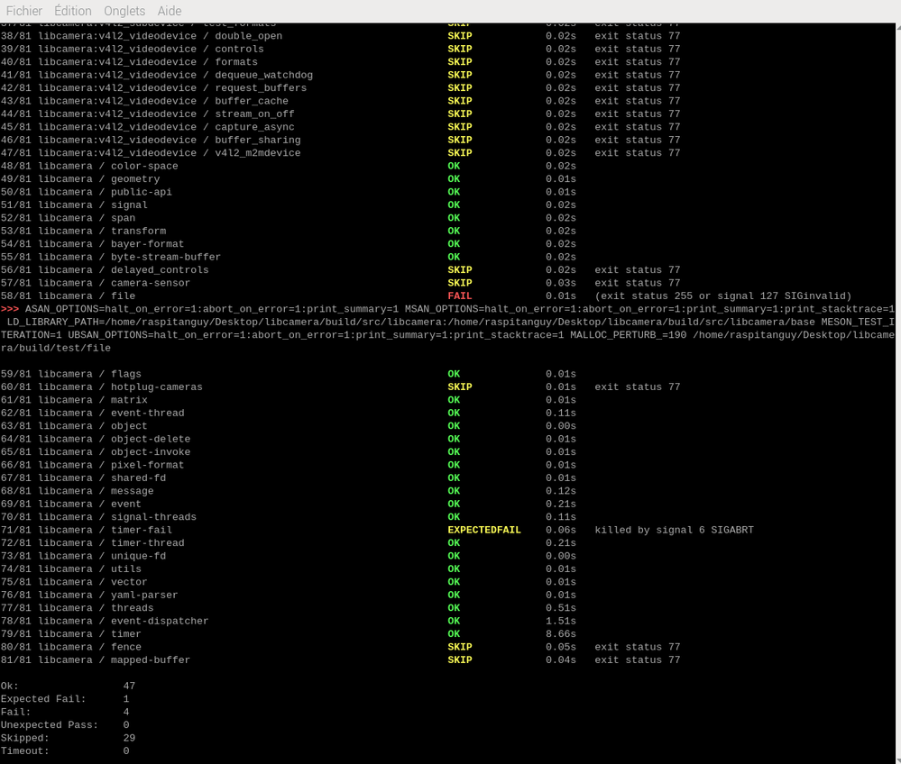

[ 2195.168147] ------------[ cut here ]------------Could you please provide your configuration so I can try to reproduce it?
Could libcamera already present during the OS installation cause issues with the libcamera provided by ST?
I've already tried displaying the camera stream from the physical CSI1 port using the pre-installed libcamera and the versions provided by St on GitHub, and I'm having the same issue with V4L2.
