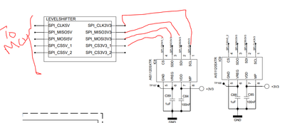

This Makes sense , i will try with oscilloscope , do you feel the level-shifter also be an limitation?
2025-06-30 1:44 AM
hi , you means upto 5Mhz data rates are working in your setup? in this case as you mentioned i use level shifter this could cause the issue. i must try with out this?please inform
2025-06-30 2:14 AM
@TDK wrote:Long wires are not going to be amenable to high data rates.
Indeed.
@anandhram1988 again, this is why you have been asked to provide schematics and photos of your setup.
If you want help, you need to supply the necessary information for people to know what's going on!
2025-06-30 2:24 AM - edited 2025-06-30 2:25 AM
Thanks, i have again attached the schematic picture , is this enough? Left side of level shifter outputs are connected to MCU MC9S08SH32 which is 5V VDD.
Working as consultant i have limitations in sharing the documents but i have attached whatever possible and necessary. Do you think other information is required.
Thanks in advance
2025-06-30 2:30 AM
Again, that's not a complete schematic.
You haven't identified what the level-shifter is.
@anandhram1988 wrote:Working as consultant
You should understand how important it is to get complete information from your clients!
Imagine if someone asked you a question like this about a product you couldn't see, and knew nothing about!
