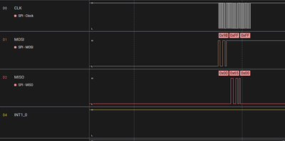

Additionally, here's a screenshot of my reading of the FIFO_STATUS register. As I mentioned, my watermark is set to 102 (0x66), but the register is showing 0x65. Note also that the FIFO_WTM_IA bit is not set. So why did my INT1 trigger?
Final note: I do have an LSM6DSV320X on order and it should be here soon. I'll test with that too, but I don't really expect the results to be any different.

I ended up resolving this issue. The problem was electrical in nature. I'm currently working with a dev kit and breakout boards with jumper cables going between them. If I increase the drive strength of my microcontroller GPIOs handling the SPI bus, all my issues disappear.
Maybe someone else having this issue has the same problem!
