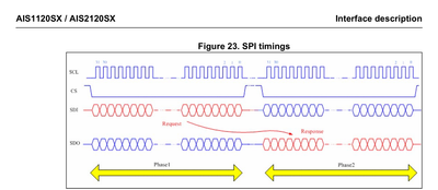

The chip expects 32-bit messages and you're sending 8-bit messages.

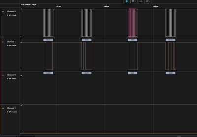

actually i also tried with 32 bit messages, you can see trace below

Show two valid 32-bit transactions back to back as it does in the example, with proper CS line handling.

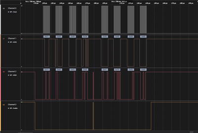

2025-06-27 7:00 AM

2025-06-27 7:15 AM
hi @Andrew Neil yes, i can see the responses from sensor, now debugging further with this but i dont know why the spi clock must be downscaled its works with <1Mhz as of now
2025-06-27 7:53 AM
@anandhram1988 wrote:i dont know why the spi clock must be downscaled its works with <1Mhz as of now
Again, you should look at the signals in the analogue domain with an oscilloscope - are they clean?
Are you still using the logic-level translator? If so, maybe that imposes a limit - the oscilloscope would tell you!
2025-06-27 9:26 AM
Looks like it's working to me.
Long wires are not going to be amenable to high data rates.
