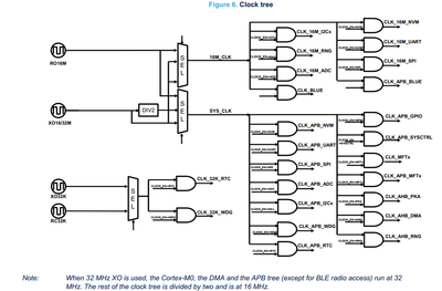

2024-03-14 5:45 AM - edited 2024-03-14 6:25 AM
Hi @Laurent LOUAZON :
accroding to following clock tree, 32M XO can be devided with 2. Do you mean even if I use 32M XO then devided with 2, ADC and Controller privacy still can't work together?
meanwhile, Is there any method that I can enable bonding with 16M XO? I can't enable bonding using BlueNRG1 and android 13. Attachment is my code.
