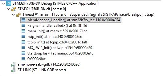

2026-02-26 10:39 AM - last edited on 2026-02-28 1:22 AM by Andrew Neil
This is a followup on this post https://community.st.com/t5/stm32-mcus-touchgfx-and-gui/compilation-error-macro-quot-bind-quot-requires-3-arguments-when/td-p/881690 . mƎALLEm provided very comprehensive answer for the issue. I was unable to post a reply hence this post. I've followed the solution to the letter using the guage touchgfx example. I got a blank white screen and this is the debug window:
and here is main.c:

/* USER CODE BEGIN FMC_Init 0 */
/* USER CODE END FMC_Init 0 */
FMC_SDRAM_TimingTypeDef SdramTiming = {0};
/* USER CODE BEGIN FMC_Init 1 */
/* USER CODE END FMC_Init 1 */
/** Perform the SDRAM2 memory initialization sequence
hsdram2.Instance = FMC_SDRAM_DEVICE;
/* hsdram2.Init */
hsdram2.Init.SDBank = FMC_SDRAM_BANK2;
hsdram2.Init.ColumnBitsNumber = FMC_SDRAM_COLUMN_BITS_NUM_8;
hsdram2.Init.RowBitsNumber = FMC_SDRAM_ROW_BITS_NUM_12;
hsdram2.Init.MemoryDataWidth = FMC_SDRAM_MEM_BUS_WIDTH_16;
hsdram2.Init.InternalBankNumber = FMC_SDRAM_INTERN_BANKS_NUM_4;
hsdram2.Init.CASLatency = FMC_SDRAM_CAS_LATENCY_3;
hsdram2.Init.WriteProtection = FMC_SDRAM_WRITE_PROTECTION_DISABLE;
hsdram2.Init.SDClockPeriod = FMC_SDRAM_CLOCK_PERIOD_2;
hsdram2.Init.ReadBurst = FMC_SDRAM_RBURST_ENABLE;
hsdram2.Init.ReadPipeDelay = FMC_SDRAM_RPIPE_DELAY_0;
/* SdramTiming */
SdramTiming.LoadToActiveDelay = 2;
SdramTiming.ExitSelfRefreshDelay = 7;
SdramTiming.SelfRefreshTime = 4;
SdramTiming.RowCycleDelay = 7;
SdramTiming.WriteRecoveryTime = 5;
SdramTiming.RPDelay = 2;
SdramTiming.RCDDelay = 2;
if (HAL_SDRAM_Init(&hsdram2, &SdramTiming) != HAL_OK)
Error_Handler( );
/* USER CODE BEGIN FMC_Init 2 */
/* Disable FMC Bank1 to avoid speculative/cache accesses */
FMC_Bank1_R->BTCR[0] &= ~FMC_BCRx_MBKEN;
BSP_SDRAM_DeInit(0);
if(BSP_SDRAM_Init(0) != BSP_ERROR_NONE)
Error_Handler( );
/* USER CODE END FMC_Init 2 */

/* MPU Configuration */
void MPU_Config(void)
MPU_Region_InitTypeDef MPU_InitStruct = {0};
/* Disables the MPU */
HAL_MPU_Disable();
/** Initializes and configures the Region and the memory to be protected
MPU_InitStruct.Enable = MPU_REGION_ENABLE;
MPU_InitStruct.Number = MPU_REGION_NUMBER0;
MPU_InitStruct.BaseAddress = 0x24000000;
MPU_InitStruct.Size = MPU_REGION_SIZE_512KB;
MPU_InitStruct.SubRegionDisable = 0x0;
MPU_InitStruct.TypeExtField = MPU_TEX_LEVEL0;
MPU_InitStruct.AccessPermission = MPU_REGION_FULL_ACCESS;
MPU_InitStruct.DisableExec = MPU_INSTRUCTION_ACCESS_DISABLE;
MPU_InitStruct.IsShareable = MPU_ACCESS_NOT_SHAREABLE;
MPU_InitStruct.IsCacheable = MPU_ACCESS_CACHEABLE;
MPU_InitStruct.IsBufferable = MPU_ACCESS_BUFFERABLE;
HAL_MPU_ConfigRegion(&MPU_InitStruct);
MPU_InitStruct.Number = MPU_REGION_NUMBER1;
MPU_InitStruct.BaseAddress = 0x90000000;
MPU_InitStruct.Size = MPU_REGION_SIZE_256MB;
MPU_InitStruct.AccessPermission = MPU_REGION_NO_ACCESS;
MPU_InitStruct.IsCacheable = MPU_ACCESS_NOT_CACHEABLE;
MPU_InitStruct.IsBufferable = MPU_ACCESS_NOT_BUFFERABLE;
MPU_InitStruct.Number = MPU_REGION_NUMBER2;
MPU_InitStruct.Size = MPU_REGION_SIZE_128MB;
MPU_InitStruct.DisableExec = MPU_INSTRUCTION_ACCESS_ENABLE;
MPU_InitStruct.Number = MPU_REGION_NUMBER3;
MPU_InitStruct.BaseAddress = 0xD0000000;
MPU_InitStruct.Number = MPU_REGION_NUMBER4;
MPU_InitStruct.Size = MPU_REGION_SIZE_32MB;
MPU_InitStruct.Number = MPU_REGION_NUMBER5;
MPU_InitStruct.BaseAddress = 0x30020000;
MPU_InitStruct.Size = MPU_REGION_SIZE_128KB;
MPU_InitStruct.TypeExtField = MPU_TEX_LEVEL1;
MPU_InitStruct.Number = MPU_REGION_NUMBER6;
MPU_InitStruct.BaseAddress = 0x30040000;
MPU_InitStruct.Size = MPU_REGION_SIZE_512B;
MPU_InitStruct.IsShareable = MPU_ACCESS_SHAREABLE;
/* Enables the MPU */
HAL_MPU_Enable(MPU_PRIVILEGED_DEFAULT);

#endif /* USE_FULL_ASSERT */please advise
2026-02-26 10:50 AM
Please note the provided guage example works fine as is no problems whatsoever
