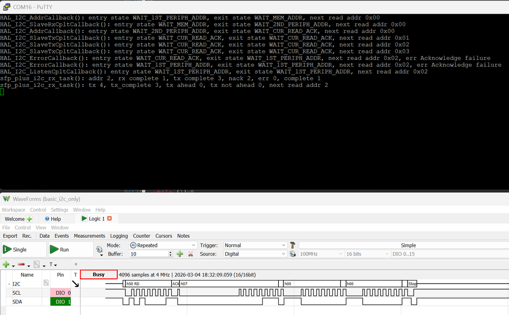

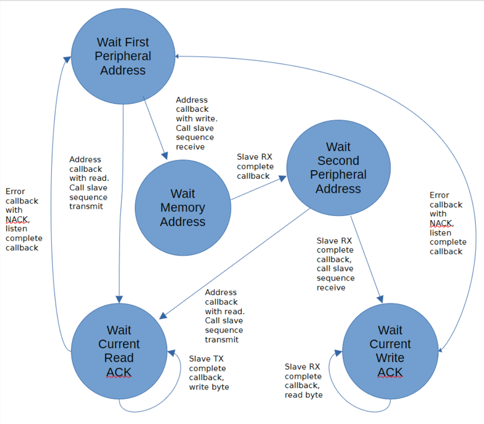

Trying to explain this with more pictures and fewer words: if I follow this state machine to respond to the two types of controller read transaction (one with memory address supplied and one without, where it is supposed to start with the internally maintained next read address):
In the Wait Current Read ACK, where I determine ACK by getting a slave TX complete callback, and NACK by getting an error callback, sometimes the state machine "runs ahead" of what is actually going onto the I2C bus. I can get one or two extra TX complete callbacks. I say "one or two" because it is inconsistent, and that's the problem - I can't assume a precise relationship between the number of slave TX complete callbacks and the number of bytes that actually went to the controller before it sent NACK.
Here's a screen shot of my Analog Discovery 2 capturing the protocol along with a log of the UART messages. The logging code queues up formatted strings for another task to send to the UART, so it slows down the execution time of the interrupt service routinse. This example shows the behavior I expect. The first command is a controller read of 3 bytes at memory address 0. I send 3 bytes, I get 3 slave TX complete callbacks, my internal "next read address" is incremented to 0x03, the I get the error callback with NACK. Why two error callbacks? Who knows, but I can ignore the second one. And please ignore the ListenCpltCallback() log line that says the next read address is now 2 - that's due to my temporary "fix" to compensate for the problem of the transmits and callbacks getting ahead of what is going onto the bus, which I'll show in the case below.

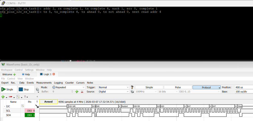

Now, here's the behavior if I turn off logging from the callbacks and only send the counts when the transaction is finished. In other words, the ISRs should be running at full speed:
The log doesn't capture all the details, but just counts: 3 bytes went out on the wire, but the state machine "ran ahead" and I transmitted 5 bytes, and got 4 TX complete callbacks, so it my code thinks the "next read address" should be 4. (Ignore the "err" count - that only records error reported by the error callbacks that aren't NACK).
Given this, my code can't figure out how to keep track of the "next read address" correctly. Does this make more sense now?
