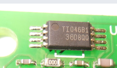

the eeprom am using is
TIOB46B1
you will not find datasheet for it
but i used to read it or write with these steps and discribtion
2024-03-14 8:46 AM
here:
https://www.eevblog.com/forum/projects/lexmark-toner-chip-ti046b1/
