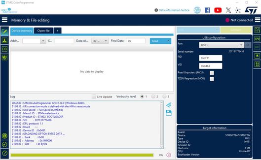

There seems to be a bug in Stm32CubeProgrammer v2.19.0
I connect the STM32F767 with USB1 (DFU).
When I press the CONNECT button, the connection stops at 44 bytes.
the connection is "Not connected"
however, I can now download a program.
2025-03-25 1:44 AM - edited 2025-04-22 7:27 AM
Hello @Hans T,
Not being able to read SRAM @0x20000000 via USB is expected since the first 16KB are used by bootloader code and are not accessible. You can successfully read SRAM contents starting from @0x20004000.
The "Not connected" not toggling is just a GUI bug and will be fixed in a future release. To work around the button freezing, you can perform a read operation.
Update: internal tracking number: 206090. Issue will be fixed in the next release.
Aziz

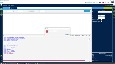

2025-03-17 1:24 PM - edited 2025-03-18 11:39 PM
Dear @Hans T ,
Can you type in Read Address the RAM address @0x20000000 : and see/send the message/log after reading ?
Thank you. @Aziz BRIGUI your help is appreciated
STOne-32.

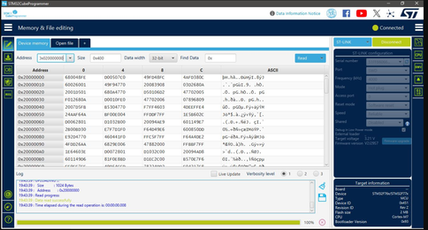

2025-03-18 11:59 AM
Hello.
I can't read the data with USB,
But parallel with the JTAG interface in HOTPLUG mode, I read this:
Hello @Hans T,
Aziz
