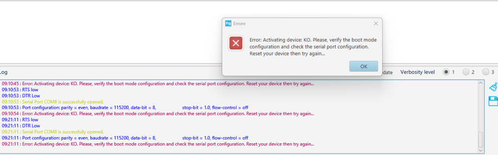

I'm trying to connect via UART instead of ST_LINK to the NUCLEO-H755ZI-Q, but it just won't connect.
First, I connect the 3.3V pin to BOOT0, and it activates in bootloader mode. Then, I click "Connect" in the STM32CubeProgrammer environment, and I get this error:

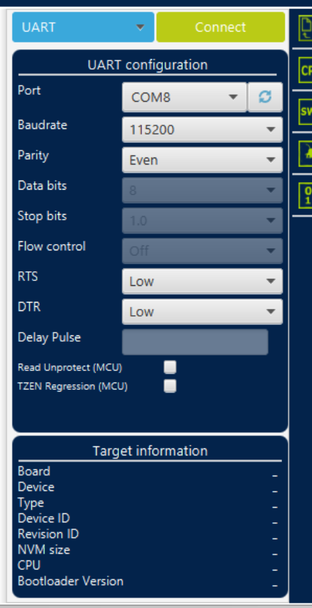

The UART's RX and TX (it's a USB SERIAL CH340) are connected to the Arduino pin PD5 and PD6 (USART2) of the NUCLEO-H755ZI-Q. Pin GND are also connected correctly. The settings on the STM32CubeProgrammer are as shown in the photo:
Why isn't it connecting, or is there something wrong?

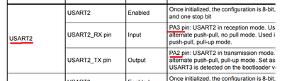

You are using the wrong GPIOs pins for USART2. AN2606 indicates the following:

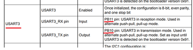

USART3 needs PB11 and PB10 for the bootloader:
While in the NUCLEO board is connected to PD8 and PD9 as indicated by the schematic:
So you need to wire connect PB10 to PD8 and PB11 to PD9, so the STLINK-VCP will be connected to the USART3 and use the ST bootloader.
