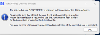

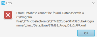

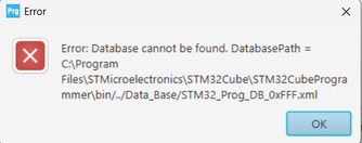

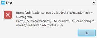

I made it to the updating the product state to 17 and was in the process of reconnecting under hot plug mode, however I didn't have success reconnecting.
I get these 4 errors:

The custom board only has swd connections, which is why I was using jlink.
This is where I was getting my errors above, it just won't connect anymore.
