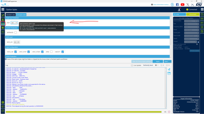

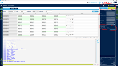

Hello Community,
I’m facing an issue while loading a firmware HEX file using STM32CubeProgrammer. The HEX file is not downloading successfully. Could you please suggest what might be wrong or provide guidance on how to resolve this?
2026-05-04 12:05 AM
This issue is usually not related to the HEX file itself but to configuration or connection problems. You may want to check points:
1) connection is ok ? make sure you selected the correct interface(st-link or uart or usb..)
2) mcu is powered ? if voltage is not detected, programming will fail.
3) if the mcu is protected RDP, can't programmed.
4) check your options bytes
Also please share the log output from the programmer.
