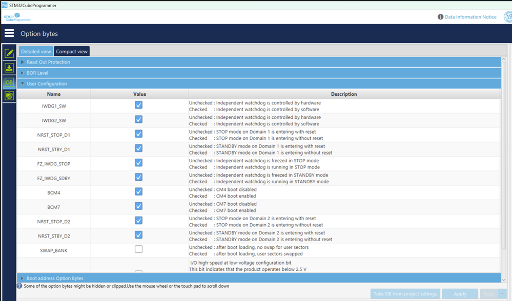

So, in STM32CubeProgrammer --> Option Bytes --> User Configuration:
I unchecked BCM7 (CM7 boot disabled)
BCM4 remained enabled
I clicked Apply
The operation completed successfully
No mass erase warning
No security warning
No RDP Level 2 warning
RDP was never changed manually.

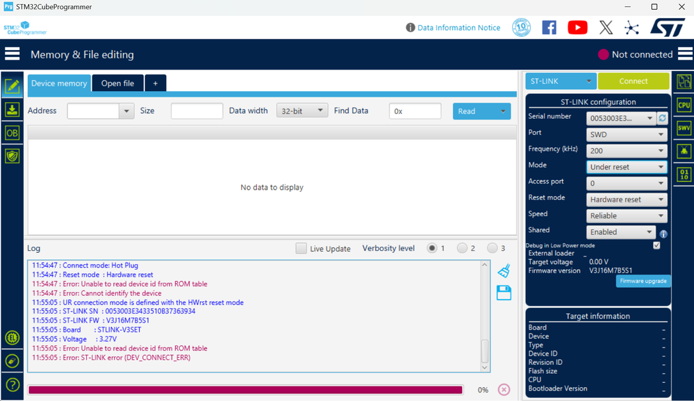

After applying the option bytes, I can no longer connect via ST-LINK.
STM32CubeProgrammer shows:
Even in:
Under Reset mode
Hardware reset mode
Hot Plug mode
50 kHz SWD frequency
Connection always fails.
Connect under reset (holding NRST manually)
BOOT0 high and low
Very low SWD frequency (50 kHz)
Hot Plug mode
Hardware reset mode
Different USB cable
ST-LINK V3SET firmware is detected correctly
Still, device ID cannot be read.

Attached are screenshots of:
Option Bytes before change

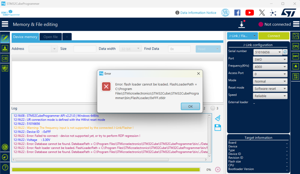

Cube Programmer connection error with ST-Link_V_3 and J-link
NOTE: With J-Link the Device Id is Detected

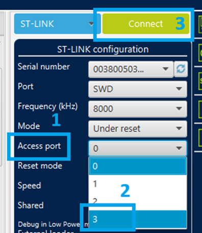

2026-03-02 11:59 PM - edited 2026-03-03 12:02 AM
Hello and welcome to the ST community.
That's a normal behavior. CM7 is accessible over Access port 0 while CM4 is accessible over Access port 3. If you disable CM7, the MCU target is no more accessible if debug access port = 0.
Set the Access port to 3 and you will restore the connection to your MCU target.
Please have a look at this article: How to enable/disable cores on dual-core STM32H7 using STM32CubeProgrammer
Hope I've answered your question.
