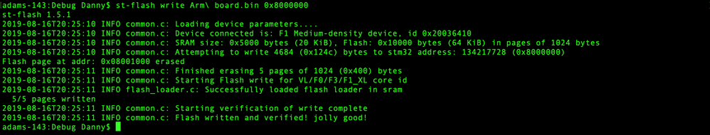

@Bob S finally found the problem :
I went on Windows and attached the st link v2, started the program st-link and disabled 'read out protection' from configuration bits, once i did that, I could write freely any program on the flash using st-link command on mac OS and booting on System Memory (Boot<1:0> = 01).
Thanks all for your help !!
