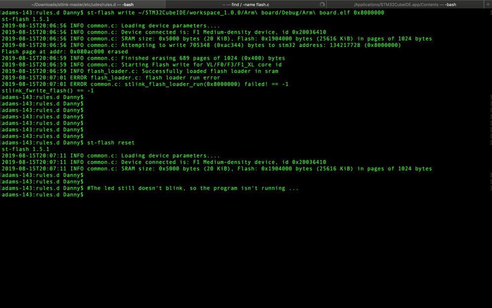

I tried to use the st-flash command in terminal, here what i get :

Something is seriously messed up!
That terminal session shows that the programmer thinks there is 25616 KBytes of FLASH (as mentioned above). And apparently your program is 705348 bytes (688 KBytes). All targeted to a CPU that really only has 64KBytes of FLASH.
So first, find out why your program is so HUGE.
Maybe the ID value that is being returned isn't valid? Look in the reference manual this CPU and see what the ID is supposed to be. Look for the DBGMCU_IDCODE register.
Hmmmm... the FLASH size may be reported by the chip itself, if the debugger is reading the "Flash size data register". This should report 0x040 for 64KBytes. So maybe the debugger connection to the chip is flakey? Or the chips are somehow messed up.
I wonder if trying to erase pages way above the actual FLASH memory region has somehow broken the CPUs? I would hope this isn't the case.
And "power is provided by an ams1117-3.3v so it's safe". That isn't necessarily so. If you don't have all the power pins connected, or you have bad solder joints, or insufficient bypass capacitors, or the power supply feeding the 3.3V regulator is somehow current limiting. Check your schematic against the closest Nucleo/Discovery board that you can find.

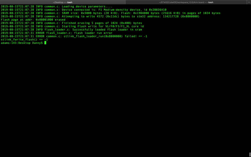

I have found a way to generate the bin file, it's only 4572 bytes but im getting the same problem ...
Im sure that the problem is software because i reviewed the pcb layout many times and tested solder points, resistors, capacitiors ...
Here is what i'm getting when i try to burn the 4.5 Kb in the chip's flash

Have you tried to read the option bytes? You may need to go back to the CubeProgrammer to do that.
Maybe look at the SWD signals on a scope. Make sure they are clean, good edges and good signal levels.
The device ID value looks reasonable for your the F103 part. Though I would still be worried about the irrational value that both CubeProgrammer and st-flash are both reading for the FLASH size. It may be a case of both of them reading the (same) wrong memory address (kind of strange coincidence). Or it may be an indicator that the chips are really not behaving as they should and maybe the flash size register isn't the only thing that isn't working right.
2019-08-15 2:45 PM
I have changed the wires for SW communication, still same result.
I don't think it's random value for the flash size, else i would have different value every time i reprogram the flash memory.
And I'm sorry but i don't know how to read the options bytes, still new in stm ...
