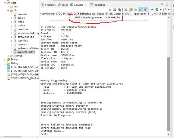

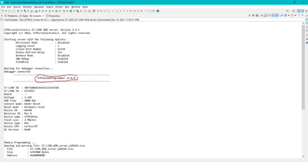

I found the problem. According to these pictures(First for STM32CubeIDE 1.8 and Second for STM32CubeIDE 1.7)
The STM32CubeIDE 1.8 uses the STM32CubeProgrammer 2.9 and this makes the problems but the STM32CubeIDE 1.7 uses STM32CubeProgrammer 2.8 and makes every things work fine.
