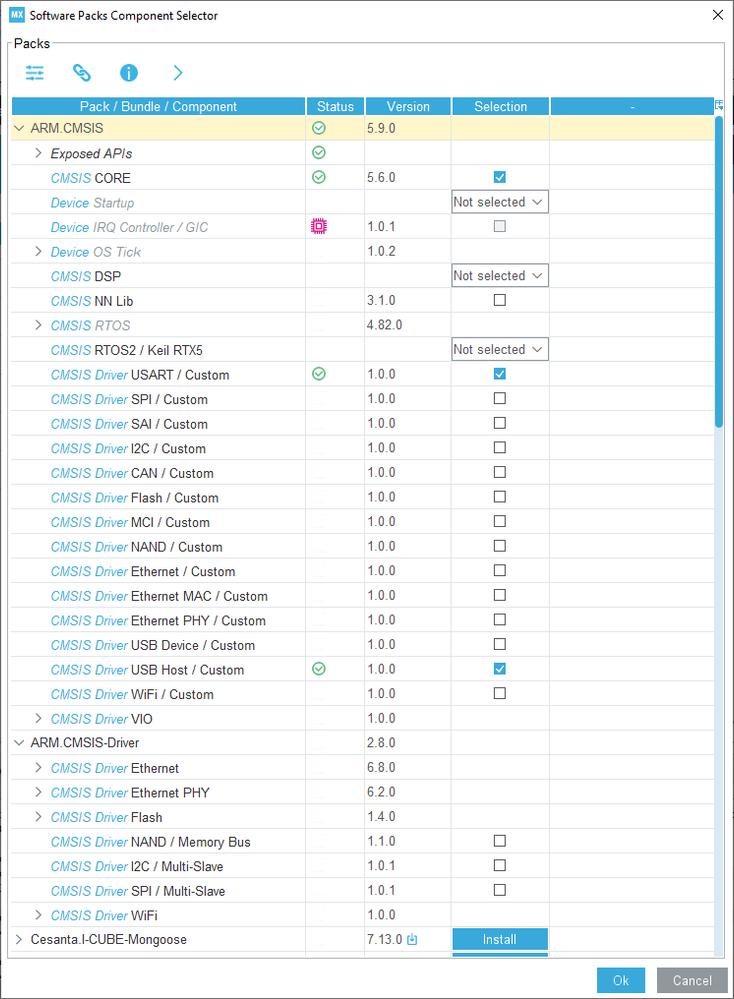

What a pain, so finally got around to trying to test our code with the CMSIS DSP, went into the component selector, selected CMSIS modules, DSP, and clicked OK, as there was no big flashing INSTALL button, and nothing happened!
It didn't install the DSP folder after code generation, sure this is easy right, but obvious it is not.

Man you seem to have an issue with comprehensive reading. You probably ignored the warning given by the component selector, and did not enable CMSIS CORE. CMSIS DSP stands on top of CMSIS CORE.
You're probably going to continue having issues that you're not going to know how to resolve by yourself. I suggest you to ignore the component selector and just copy and paste the source code:

Here is what I have configured in stm32cubeide:
Is this enough? (Why is there no USB under ARM.CMSIS-Driver?)
