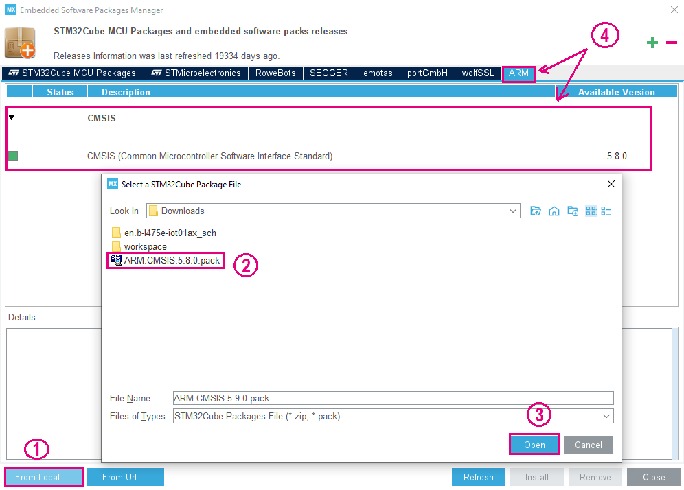

The CMSIS pack can be downloaded from arm website and then imported locally in CubeMX, please refer to the picture below,
I hope this helps !

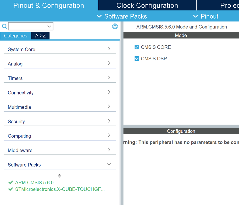

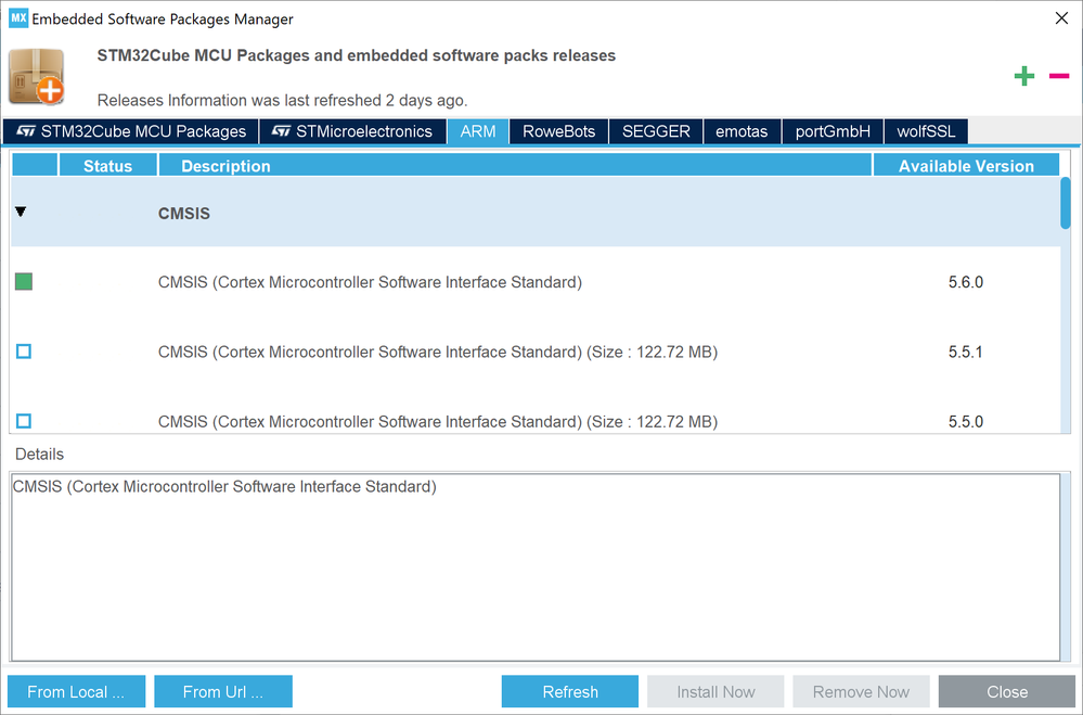

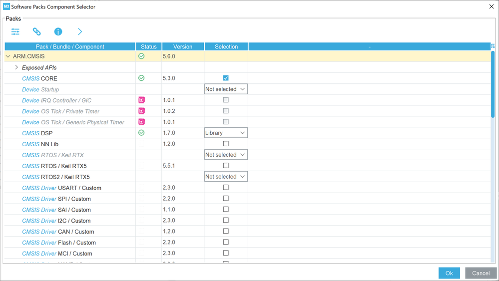

Ok in 1.7.0 i can make two clicks and all is setup in IDE.
Version placed in project is arm_math.h
* @version V1.6.0
* @date 18. March 2019but, in fw folder STM32Cube_FW_F4_V1.26.2 same file
* @version V1.5.3
* @date 10. January 2018as you can see MX dont place DSP from fw , but newer.
??? ofcourse too lib files is very different = very unclean

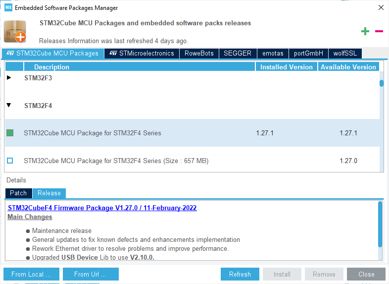

PS: the most recent version of your arm_math.h is the same as in the F4 1.27.1 fw version, so maybe you have already download it too.
thank you,
2022-11-09 10:59 PM
I ever use my stable IDE and compare with latest, now 1.7 vs 1.10
In 1.7
and PS 1.27.1 have file
* @version V1.5.3
* @date 10. January 2018same as 1.26.1 , but older as from ioc MX in 1.7

Hello @MM..1 , @Robmar , @eLuigi ,
Thanks for your feedback,
I hope this helps !
