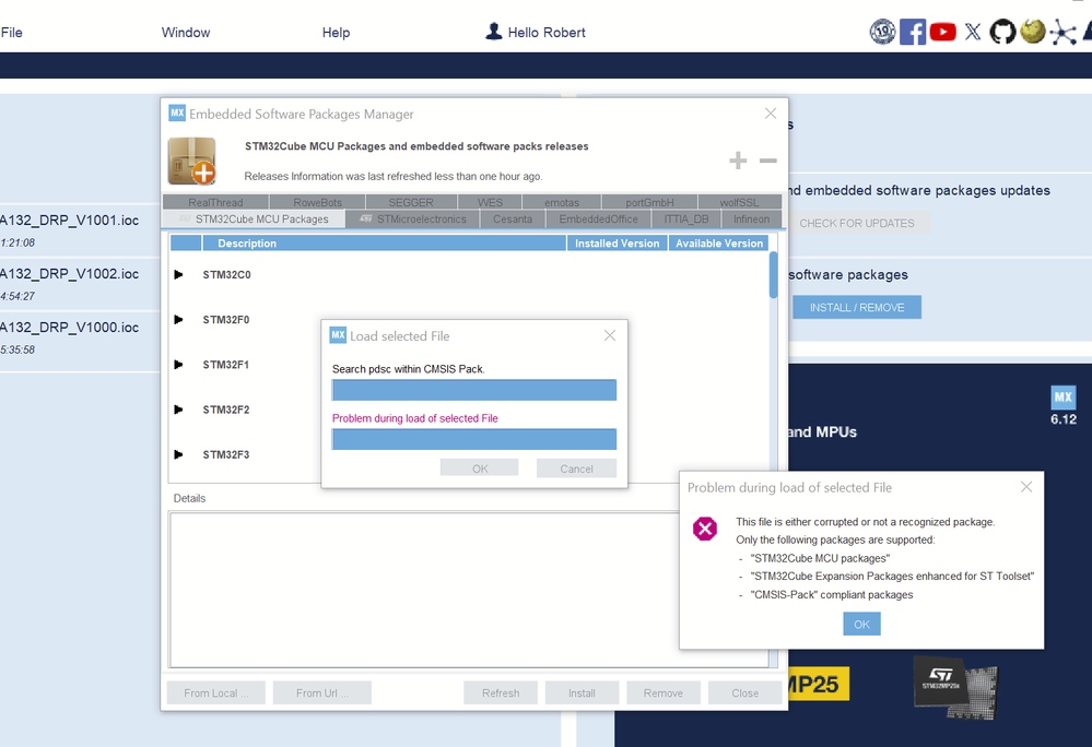

2024-10-04 3:07 PM
I have the same issue when I was trying to setup 'AWS IoT software expansion for STM32Cube' which was downloaded from 'https://www.st.com/en/embedded-software/x-cube-aws.html'.
I will appreciated it if you could provide instructions so I can use FreeRTOS for STM32U5 in CubeMX.
Regards,
Robert

Hi all,
I do have the same problem. Can´t update STM32Cube MCU packages, neither via URL nor via local file => "This file is either currupted or not a recognized package."
I tried stm32cube_fw_l4_v1180.zip and others, no way to get updates for CubeIDE. So I´m stuck with 1.16.0 from 2020 for the L4 and there are severe bugs in the HAL (missing atomic I/O modifiers, which are introduced in newer versions, like ATOMIC_SET_BIT).
Any advice is welcome!
