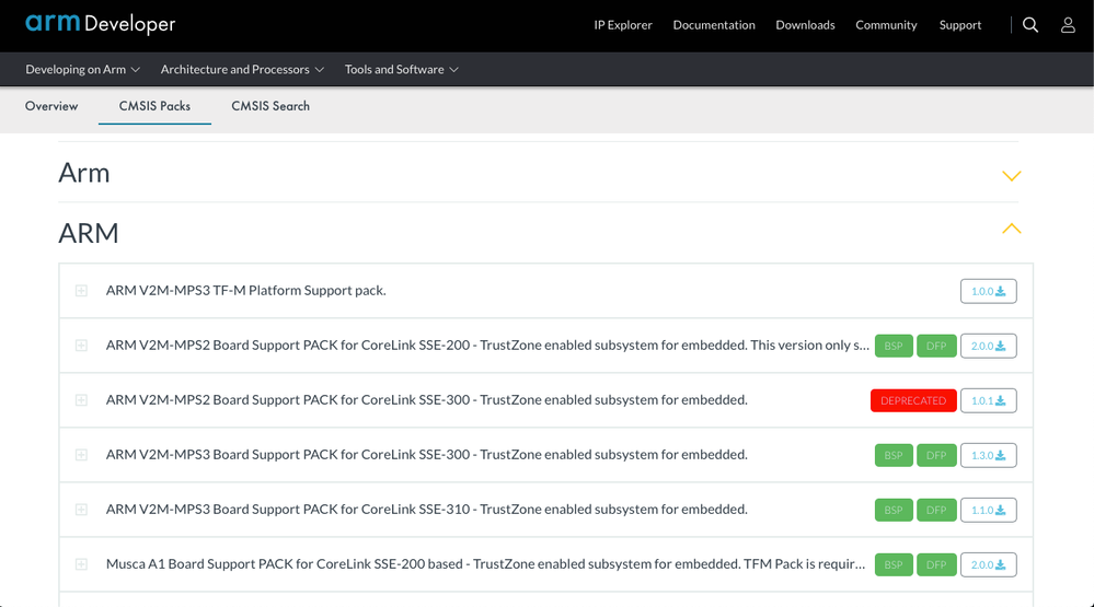

You can find the package at this url https://developer.arm.com/tools-and-software/embedded/cmsis/cmsis-packs
you can download it from ARM -> CMSIS
The package 5.8.0 works for me but not the 5.9.0

Hello @Robmar ,
Sorry I couldn't copy the direct link, anyways the CMSIS pack is placed under: ARM -> CMSIS (Common Microcontroller Software Interface Standard).

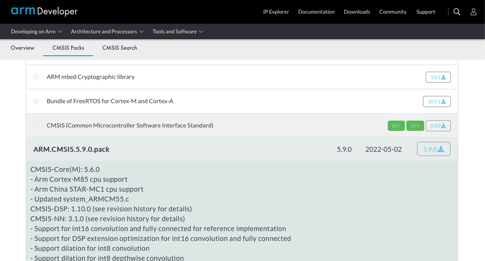

Thanks, so we should install ARM.CMSIS-DSP.1.14.1.pack ?
Confusing as eLuigi mentioned 5.9.0 didn't work in his STM32CubeIDE, and there is no sign of that version number on the ARM page.

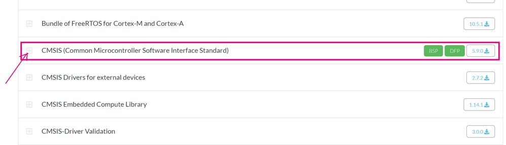

Hello @Robmar ,
You should install ARM.CMSIS.5.8.0.pack, I also couldn't install v5.9.0.
@eLuigi screenshots shows where to find the pack. You need to click on the "+" that is next to "CMSIS (Common Microcontroller Software Interface Standard)" to list the available and different versions of the CMSIS pack.
You can find the "CMSIS (Common Microcontroller Software Interface Standard)" above "CMSIS Embedded Compute Library".
