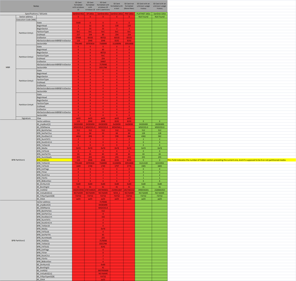

I've been studying the difference between the SD Cards that function with the application and others that don't. I've found that SD Cards that function have the BPB at sector 0 and have no MBR, And their primary partition is not shifted.
Cards that have an MBR at sector 0, have a primary partition that is shifted. At the first sector of the partition there's the BPB that tells that the media is partitioned with a BPB_HiddSec != 0. In this case working with a STORAGE_LUN_NBR = 1 isn't compliant with what the BPB tells. ( I attached picture a showing more information about my cards)
