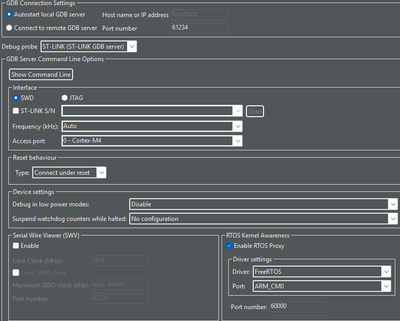

and here is my debug configuration settings
I also made sure within the .ioc file USE_TRACE_FACILITY, USE_STATS_FORMATTING_FUNCTIONS, are all enabled.
