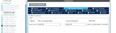

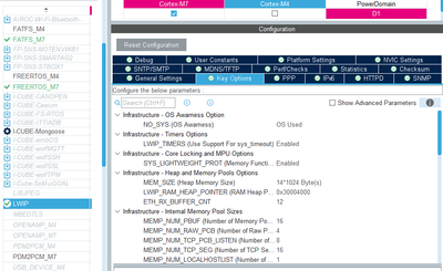

I set MX in this way:

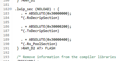

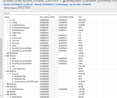

The linker script
ethernetif.c

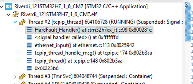

I compiled and I connect ethernet cable and it seems work poperly because if I ping I obtain right answer,
but! sometimes processor goes to HardFault

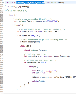

I've writed simple TCP server that accept connection on port 100 and send "Hello" every second.
When I try to connect with TERA TERM it goes immediately on HardFault.

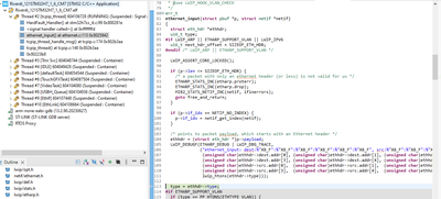

Here the code of ethernet_input

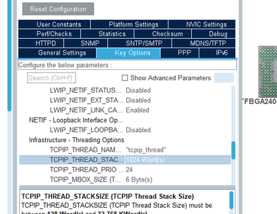

Cuold be insufficient stack size.
Look at the ethhdr pointer and ensure it's valid. If it's not, set up a hardware watchpoint to see where and when it's changed.
2025-04-30 5:42 AM - edited 2025-04-30 7:19 AM

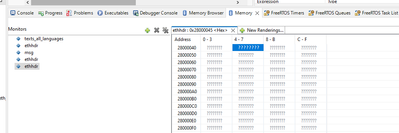

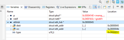

Yes TDK I watch the address: is 0x28000045
and ethhdr->type is 0x24001b64
how to increase stack size for tcpip_thread ? maybe TCPIP_THREAD_STACKSIZE ?
2025-04-30 6:06 AM - edited 2025-04-30 6:08 AM

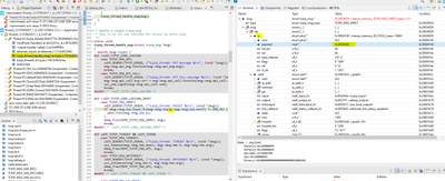

it seems msg->msg.inp.p point to invalid address: 0x28 ...
No RAM @ 0x28...
2025-04-30 7:18 AM
what do you intend ? set up a hardware watchpoint to see where and when it's changed
how can I see whene it's changed ?

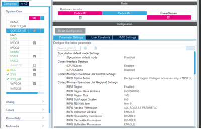

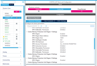

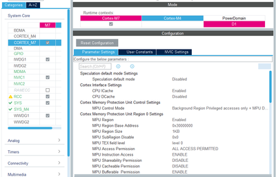

Another question that I want to higlight, counld be that I have not enabled D-Cache ?

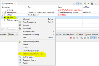

Here's how to set a watchpoint:
You want to watch for the pointer to change, so add ðhdr as the expression.

Have you increase the stack size from STM32CubeMX as you show on one of your messages ?

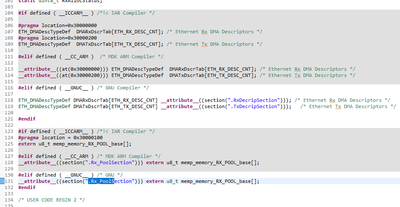

Can you check that the types on line 113 match, also check that ethhdr->type is properly initialized ?

Not enabling D cache should not be an issue.

Watchpoint is disabled maybe ethhdr is a local variable

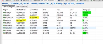

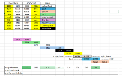

When I go to HardFault I shot the stack and see if one thread stack overlap the next but I don't see this situation
