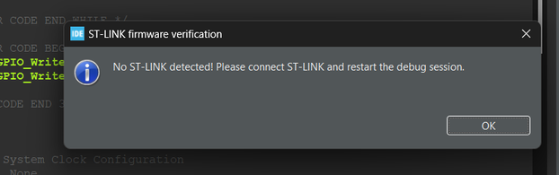

The compiler tells me:

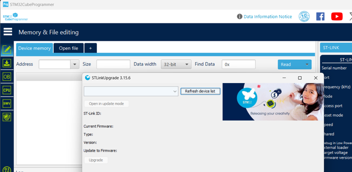

So I tried again to update my driver but :
And on STM32CubeProgrammer/IDE :
tried to update my driver with stsw-link009 but nothing new.

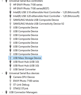

In the device manager I see that when my card is plugged in :
My card is powered up with LED 2 on and my computer doesn't detect my card. I've changed the port card and the usb cable but nothing.
I uninstalled the driver, firmware and STM32CubeIDE/MX/Programmer, then reinstalled them. Nothing new.
But now I don't see st-link... in my device manager:
