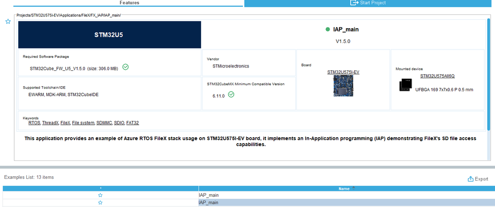

I want to test the "IAP_main" example for the STM32U575I-EV.
I start the project as follows :

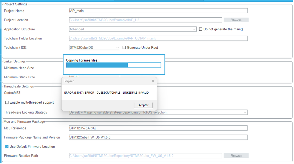

Then when I try to Generate Code for the STM32CubeIDE in CubeMX the following error occurs:

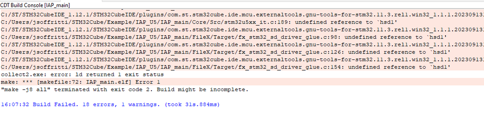

The code gets generated and I can open it in STM32CubeIDE but it doesn't build properly:
The build errors says that the MX functions called in the main file are not linked and there is no reference to them.
I have attached the build log where the errors are displayed.

Hello @jacopokunak and welcome to the Community :)
I can't reproduce the issue when using the latest release of STM32CubeMX (v6.11.0) and STM32CubeIDE (v1.15.0).
Could you please try with STM32CubeIDE v1.15.0?
Then, please keep me informed about your update.

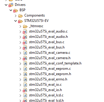

2024-04-04 7:13 AM
Try with standard setting : ..under root ->
2024-04-04 7:48 AM
Hi AScha.3,
If I select Generate Under Root the first error disappears but new build errors are generated:
All these files do not build.
2024-04-04 9:28 AM - edited 2024-04-04 9:30 AM
So look at the errors , it telling why...especially the first error (often same reason (include missing etc.)).
Or show it. :)
Do : generate code (again) in Cube/ioc , then compile again.
