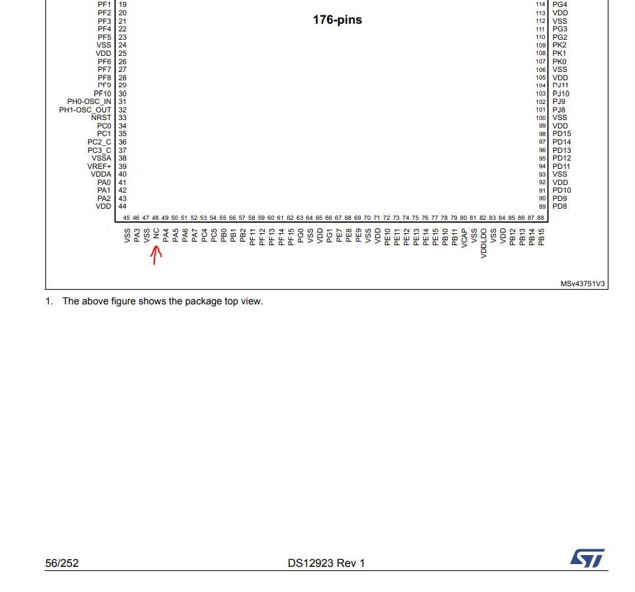

There is a difference between CubeMx and the datasheet. from Pin48
https://community.st.com/s/?t=1610970558389
page 56/252

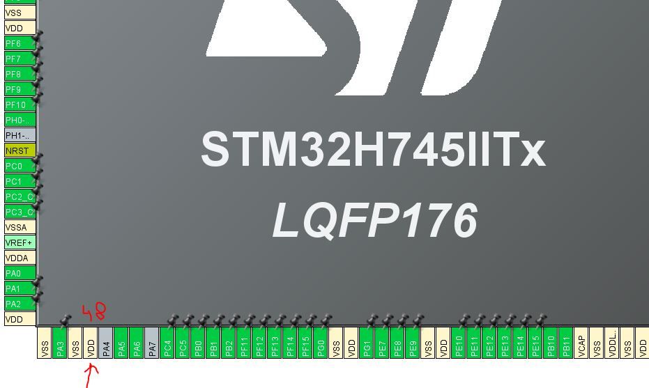

Datasheet pin48 = NC
CubeMx pin48 = VDD
What is right ?
2021-01-18 4:21 AM
Hello Hans T,
Thanks for your feedback. You're right, the issue will be reported internally to be reviewed and fixed.
I'll keep you posted.
Thanks for contribution.
Khouloud.
