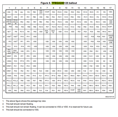

2024-02-22 7:02 AM
In datasheet it's NC while stm32cubemx says it's VSS
It doesn't matter I think

Hello @Tokit
As you can see here:
The PIN NO.F1 is compatible on datasheet (DS12556Rev7) and CubeMX configuration. I think you are using an old revision that has been updated.
Best Regards.
STTwo-32

2024-02-22 10:10 AM
@Tokit some additional information: the data sheet from which you took the screenshot is the old rev 6. The screenshot from @STTwo-32 is from the newer and corrected rev 7.
Regards
/Peter
2024-02-26 8:26 AM
Thanks.Datasheet on semiee is outdated
