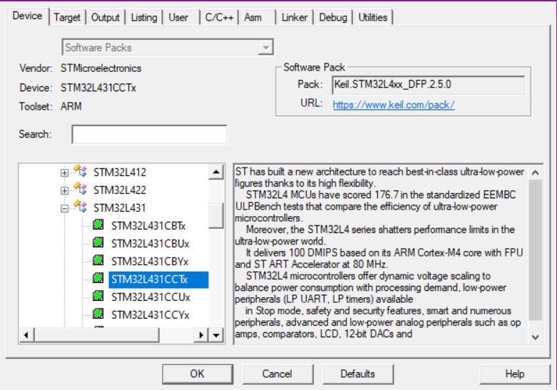

  • Going to Options for Target -> Device and changing the device to the STM32L431CBTx

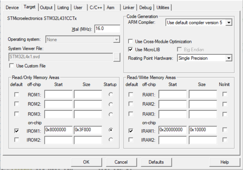

  • Going to Options for Target -> Target and change the Flash region since the size is smaller on the STM32L431CBT6, and verifying that the SRAM region is correct

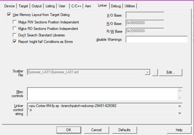

  • Verifying that the Linker is correct, which can be found under Options for Target -> Linker, and optionally, verifying that the scatter file generated is correct

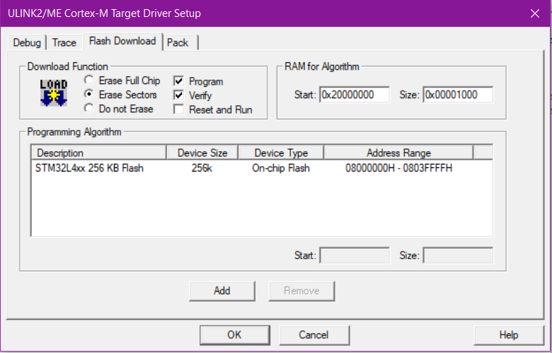

  • Verifying that the Flash region listed under Options for Target -> Debug -> Settings (button on the top right) -> Flash Download is correct, and that the 'RAM for Algorithm' section is correct
