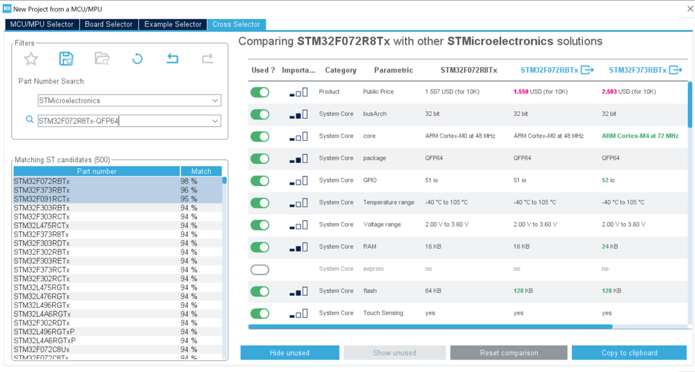

I'll take this opportunity to present you a way to compare two or more MCUs and it is through the Cross Selector under CubeMX as mentioned in the image below:

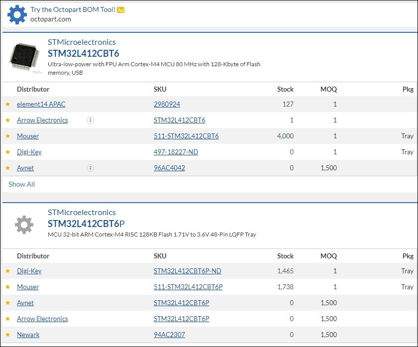

> STM32L412CBT6 in a product and now discover that it is going obsolete

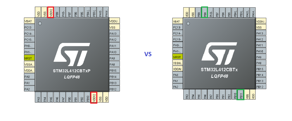

Hi @NW27​
The VDD12 is present, you can check the pinout view on CubeMX ( sorry for the missing information in the DataSheet ).
0693W000007CzwcQAC.pngThe 2 pins which are additional compared to STM32L412CBT6P are PB11 and PB8.
For more details, please refer to L4 documents under st.com.
Thanks for your contribution, Khouloud
I could confirm that figure is correct. Documentation update is ongoing.
