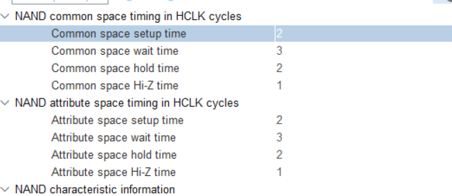

Im using MT29F1G08 as an external flash. I want to use fmc and cubemx as a code generator.
I cant find some of he timings in the datasheet and Im a bit confused.
We have a lot of setup time in the datasheet and i dont know which one is it.
And i dont know the difference between common and attribute timings. There is no attribute and common timing in the datasheet.
The wait time and HIZ time is not in the datasheet either.
Thanks.

Hi @Arman Ilmak ,
Please refer to the RM (Reference Manuel) of your board, it contains more details.
For example, if you are using an STM32L496 you will find under section 16 (RM0351), all you need to know about FMC.
Regards,
Sara.
