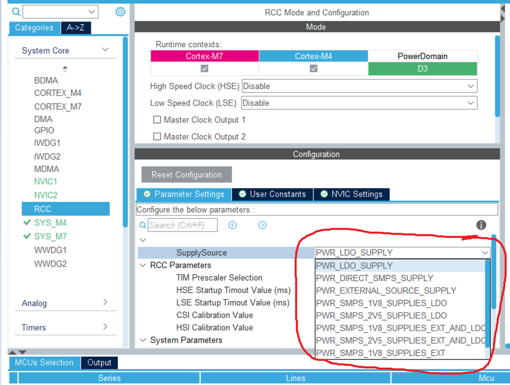

Configuration tool auto generated code SystemClock_Config() calls HAL_PWREx_ConfigSupply(PWR_DIRECT_SMPS_SUPPLY). For my hardware i need to use PWR_SMPS_1V8_SUPPLIES_LDO with no voltage scaling. I cannot find where to change the power supply configuration.
2021-01-18 6:51 AM
In RCC settings.

@TDK Thank you
