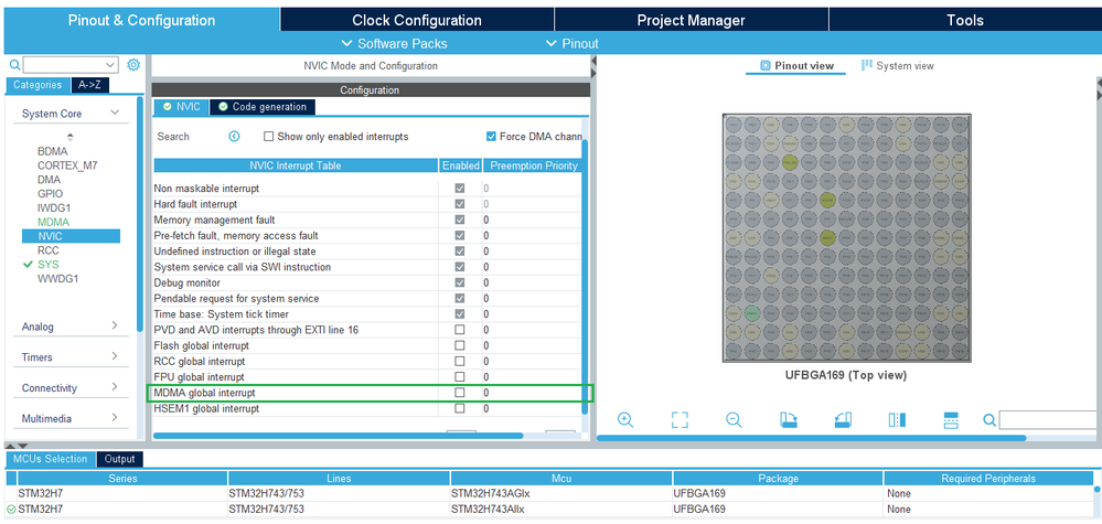

Taking the example of STM32H743 MCU, MDMA global interrupt could be enabled through the NVIC Interrupt Table:
Thus, MDMA_IRQHandler () will be correctly generated in the stm32h7xx_it.c file.
