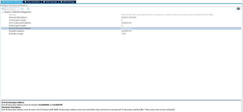

Sorry, I mistyped the described range. It's
First Rx Descriptor Address
First Rx Descriptor Address must be between 0x24000000 and 0x30007fff.
Parameter Description:
Fisrt Rx Descriptor address must be only in the D2 Domain AHB SRAM. Rx descriptor address must not exceed Max value and must no overlap with Tx descriptor and Rx buffer. These areas must not be cacheable.
See the screenshot. See the red 0 instead the previous 4.
Address range.
Kind regards
