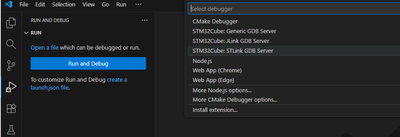

2025-10-27 12:49 AM
Thanks a lot dear, now i can build my code
But how to flash my code to the board
