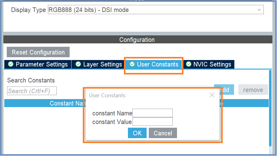

Actually, it's possible to create user constants for both FMC and LTDC by assigning for each constant a value (as mentioned in the image below), then they will be generated in your project.
You can manipulate these constants later according to your need in the code, but there's no option in CubeMX that connect user constant to other IPs.
