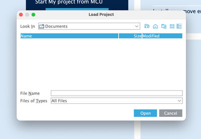

I recently switched to Mac Tahoe 26.1 and it seems since then stm32CubeMX 6.15 is not listing the contents of my Documents folder anymore. It doesn't seem like a rights management issue since
And yes, the folder does have contents and is not empty as shown in the screenshot from the file open dialog attached.
Anyone experiencing similar issues? How to come around that?

I don't agree that is cutting it. Other user folders, such as Music, the dialog is enumerating just fine, and it has got identical rights settings. There must be something else going on.
In addition, the issue doesn't seem to appear widespread in the forum. I deem that would be different if there is a general core issue using CubeMX on Tahoe.

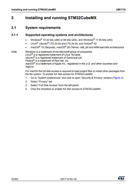

2025-11-19 11:13 PM
2025-11-22 4:48 AM - edited 2025-11-22 11:44 PM
Great, thank you Ghofrane.
Now that I moved to CubeMX 6.16 and the support question is sorted, the issue is still persistent. Can we try to dig the original issue described above, now? As you can see in the screenshot, the Documents folder is not enumerated.
Thank you,
Oliver

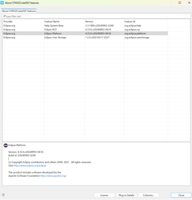

I have tried the STM32CubeIDE 2.0.0 and there is still a bug - highlighting multiple lines in the IDE is not working - for example, if you wanna select function from top to bottom, you see only the last line highlighted.. (Its just highlighting, if you do ctrl+c, you will copy all selected lines, they are just not highlighted.. )
This bug is related to the Eclipse Core and the latest macOS update to Tahoe 26.1.
(Note: in version 26.0 it was still working.)
https://github.com/eclipse-platform/eclipse.platform/issues/2244
There is also a solution available, and for Eclipse itself the issue has already been fixed.
Since the bug is in the core of Eclipse, it cannot be resolved through any settings - new release of the IDE is required.
BR.
Milan
2025-11-24 1:40 AM
Hello @msedlak
At present, STM32CubeIDE 2.0.0 is built on Eclipse Platform version 4.33.0.v20240903-0618
The migration to a newer Eclipse version within STM32CubeIDE is planned for next year.
