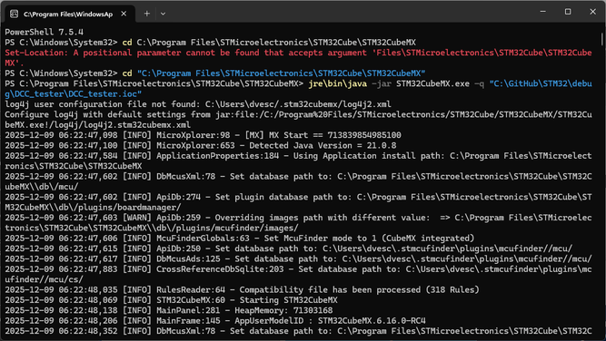

2025-12-09 3:28 AM
I suggest you actually try it before offering it as a solution.
Here is what I get:
Dumps a lot of *** ... opens the CubeMX IDE ... which I do not want ... does nothing no code generated!

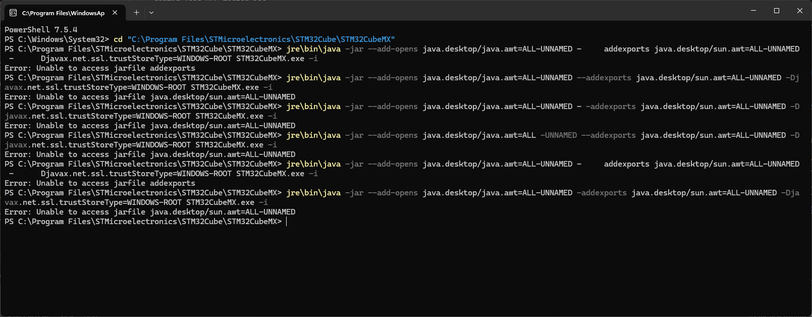

2025-12-09 4:20 AM
So I tried to launch in interactive mode copying the line from UM1718
I get:
Tried several variations assuming it was the CR/LF in copy/paste causing problems ... sill cannot get it right.

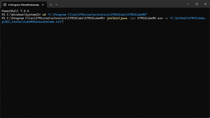

So next I tried launching a simple script. ...
I know the .ioc file at C:\GitHub\STM32\debug\DCC_tester\DCC_tester.ioc is perfectly valid as I can just click on it in Windows Explorer and CubeMX launches and loads it just fine.
I created a simple script named CubeMXGenerateCode.txt with the following two line:
config load "C:\GitHub\STM32\debug\DCC_tester\DCC_tester.ioc"
exit
I placed it in the same folder as my other project and .ioc files.
Tried to launch it with:

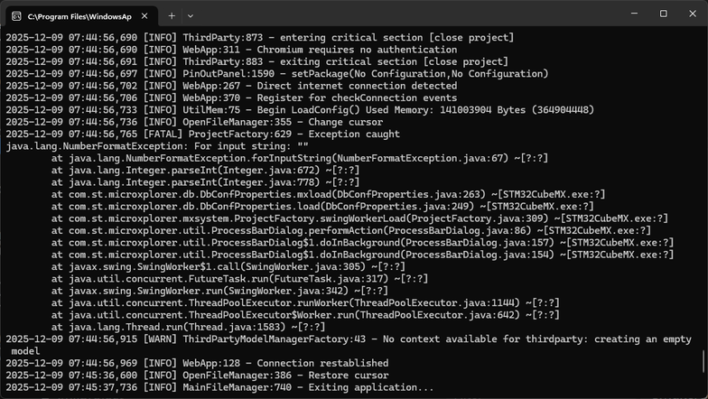

I get:
dump window:
2025-12-09 8:23 AM
Hello @dvescovi
It seems that your IOC is corrupted or you tried to open it with a non-compatible version. Could you attach your ioc to investigate the problem?
