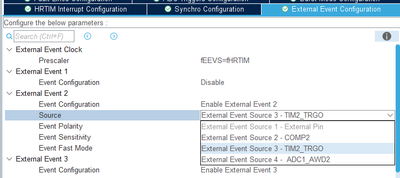

I did the exercise and I can see TIM2 TRGO is not grayed out for HRTIM external event 2 source:
and can be selectable:
What MCU part number you've set in CubeMx?
I've attached my ioc file.

I tried also the part number you are using and having the same result. As you can see I'm able to select TM2 TRGO as external event 2 for HRTIM:

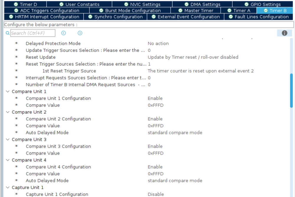

and setup as example Timer B : Enable all 4 Compare Units , disable the Capture units and set the 1st Reset Trigger Source to the "Timer counter is reset upon external event 2"
These are all relevant configurations for choosing/using the external events...

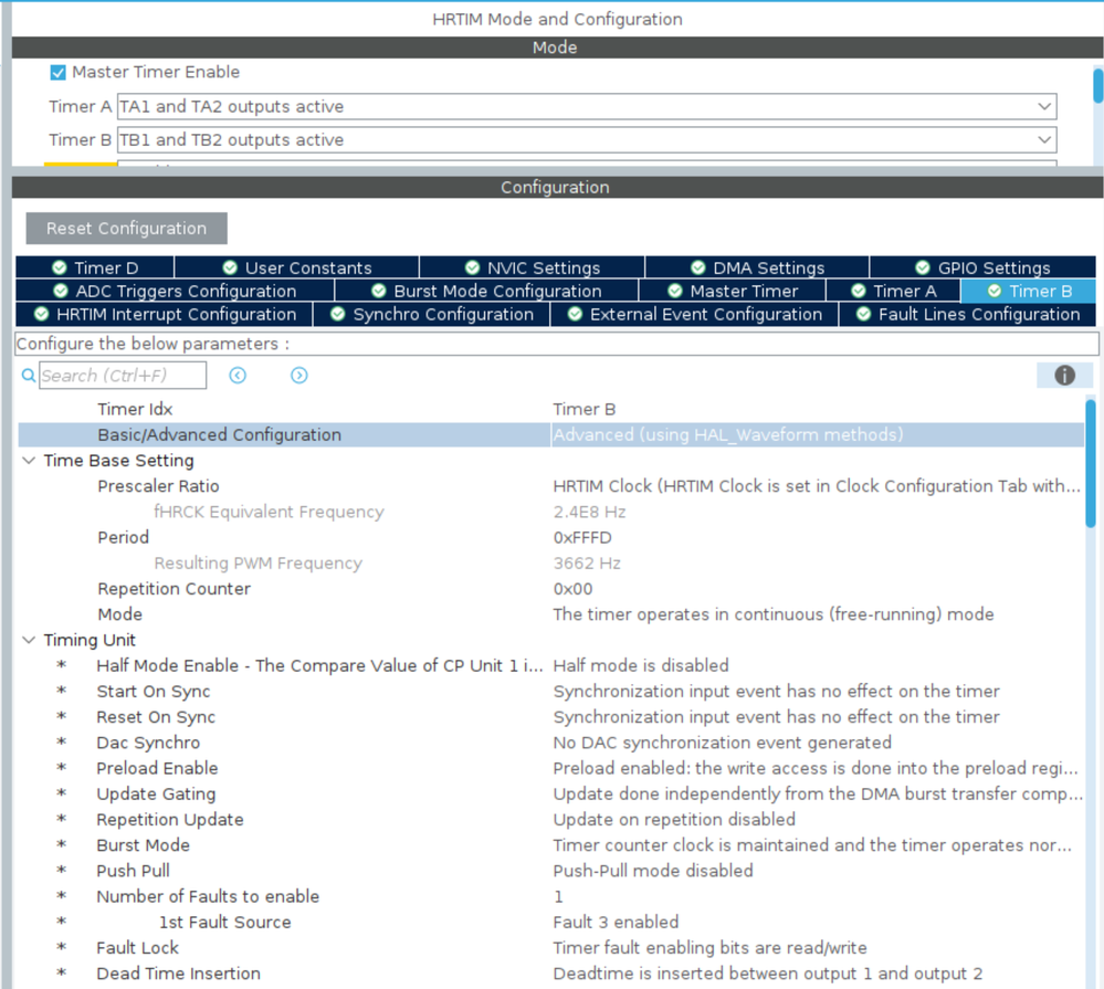

here are the main relevant parameters for this example Timer B setup . As per this configuration Timer B must be triggered By External Event 2 (which is TIM2 TRGO) ....
Please let me know if you have the TIM2 TRGO enabled as External Event for triggering Timer B thus been setup.

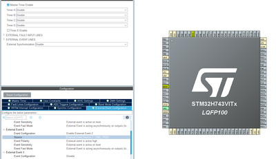

your .ioc file does not have any of HRTIM timer units enabled.
Here I attached a simple basic .ioc file Test_HRTIM.ioc for testing . It has HRTIM enabled with only one timer A enabled, been reset by External Event 1, , single External Event 1 enabled and TIM1 configured to generate TIM1 TRGO output.
Can you load this in CubeMX and see if you get a External Event 1 Source TIM1 TRGO for Timer A ?
I only get "External Event Source 1 - External Pin" , Source 3 - TIM1 TRGO inactive. Again my MCU STM32H743VIT6 .
Please let me know, Thanks
2026-04-30 2:01 AM
TIM1 TRGO option is grayed out. Only External pin is available:
