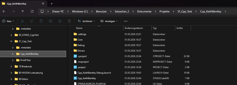

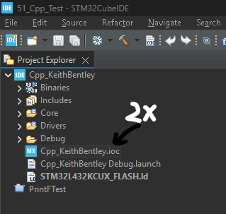

1) CubeIDE shows the ioc-file in the project tree, and is physically stored in the folder as the project (see attached screenshot)ioc-File in product tree and storage location
Note that workspace is "Cpp_KeithBentely" (I'm investigating usage of C++).

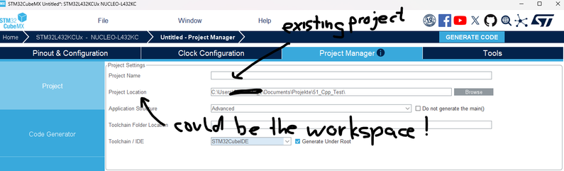

So why is the ioc-File not directly saved in the location of the project? And the need to refresh is somehow indicating that there is a link between the ioc-File generated by CubeMX and the ioc-File used by CubeIDE. As, hopefully made clear enough, there are two ioc-files ... Shouldn't be one sufficient?
So, why not simply doing something like, where the new ioc-file is directly stored inside the workspace's folder on the harddisk. Note that project location is actually the workspace!
What I simply fear is something might be broken by doing so. Bascially because I haven't understood this eclipse-world just to a minor fraction in best case.

Probably some misleading wordings in the GUI of STM32CubeMX - I had similar thoughts as you, but at the end, in conjunction with "Project Name" a sub-folder is created (named what has been entered in the field "Project Name") under the folder "Project Location", which actually STM32CubeIDE will identify as workspace later on.
So, with "Project Name" = "Cpp_KeithBentley" and "Project Location" = "51_Cpp_Test" I get the folders as shown below, and its equvialent in CubeIDE
File Locations
View in CubeIDE
So root directories are actually not the same. The project is one level below.

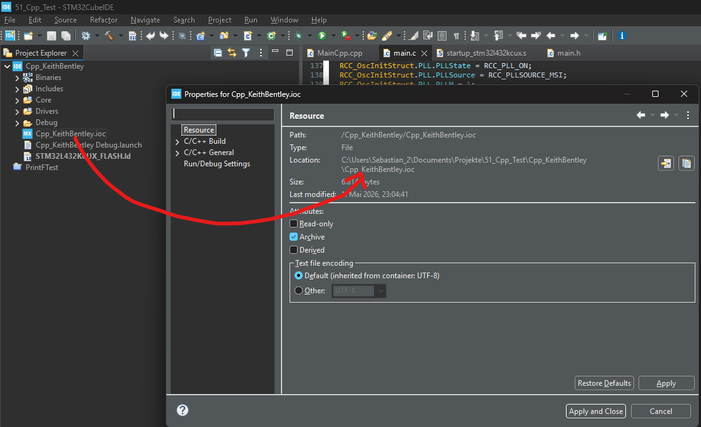

Despite, what came into my mind is that there seems to be a link between the original ioc-file and the imported one. I.e. the imported ioc-file at one physical location is still linked to its origin at another physical location. So when taken from another project it will updated also when its original has been updated. Kind of bad if not desired. A solution could be if it is possible to break that link - any chance to do this?

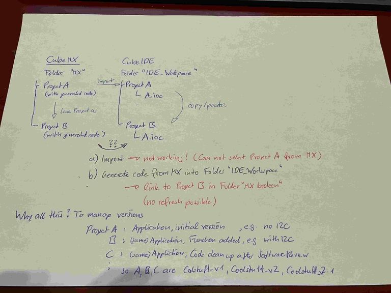

2026-05-07 2:34 PM
still not on the road of success.
First have a look on my sketch below, in which I tried to draw what I like to do.

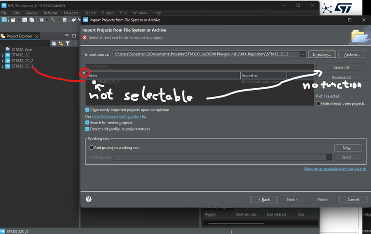

So, far I have seperated folders on harddisk to seperate projects created by CubeMX and CubeIDE. On the bottom the desired "what I want to do" is outlined. It is developping an application with several version (initial, a feature added, code clean up)
So far, the intial phase is doing fine. Project created in CubeMX in folder MX, generated code (in CubeMX), then close CubeMX, open CubeIDE and import project into CubeIDE. Link to ioc-File in Folder MX is maintained, i.e. when I modify something here, it will be updated in CubeIDE automatically, fine!
But then, Project B is created (i.e. the next version) by copy and paste (because I like to maintain all my user code). Then, ioc-File is not anymore referenced to the one in folder MX but in folder IDE (well, a copy created in IDE, so appears logical)
Unfortunately (see black arrow with ???) the import function is not available anymore, see below (Please note that I trying to import from folder MX (here: MX_Repository). It is not selectable (box can not be ticked, button select all is not doing anything)
Well, what does work is when I generated code directly from CubeMX into the workspace of CubeIDE - to the price that all user code gets deleted :( (there is a corresponding warning up front, so not a surprise at the end)
Now one my say: I try manual version control through creating various projects. Hm, yes, this is somehow the intention.
So it sounds like manual merging, but, huh, that doesn't sound very smart. Except there is a list of files/folder I can just overwrite as long as the MCU (/board) remains the same? Ehm, really?
No, I don't get it. With CubeMX as stand-alone application, projects in CubeMX have their own lifecycle, which can be, in general, different to the projects in CubeIDE. Still not where I like to be ...
