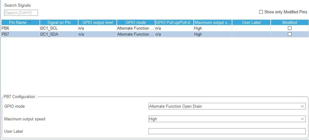

I'm trying to imitate an I2C solution. I'm using STM32F100RB.
When selecting I2C ->

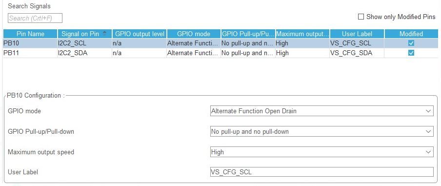

In the example, they have these GPIO settings for I2C pins:
Note the GPIO Pull-up/Pull-down option:
Here is mine:
The CUBE version is identical.
The I2C configuration is identical.
What could be the reason?
Thanks!

​Hello @ISeed​ , It's reported internally for further check .

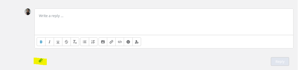

@ISeed​  ​could you please send me the ioc exemple ?
yes, of course. How do I send it to you?
@ISeed​ select this Icon then ​upload the ioc exemple file.

​This is your ioc file , could you please share the "example" ioc file where did you find GPIO Pull-up/Pull-down option ?
Thanks!
