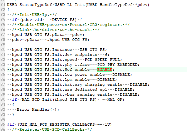

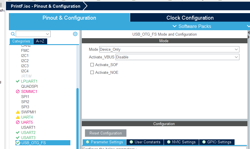

USB_OTG_FS: In one of two projects unselecting "Activate_SOF" in the .ioc environment doesn't disable its entry in the code! Error of the IDE or is there something else keeping the SOF enabled? As said, in another project it works a as expected.

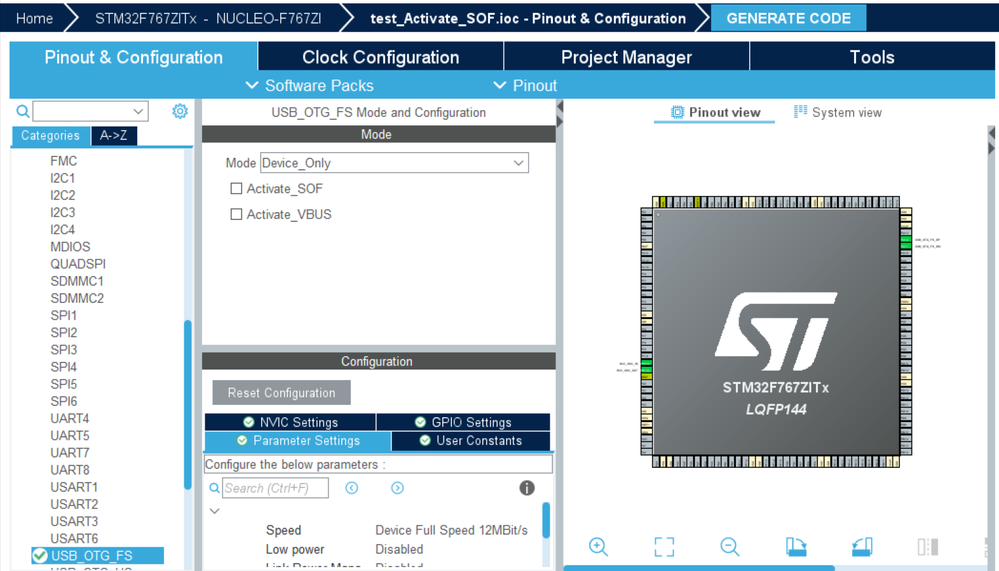

Hi @NRoth.1
I reproduced your configuration using stm32cubeMx 6.6.1 and Nucleo-F767ZI
I kept SOF disabled then I generated the code using
stm32cube IDE and also keil I found that is working as expected
could you please give me more details about your version of stm32cubeMx and your SOC
Ghofrane

2022-08-23 2:33 AM
As mentioned already, it is probably not easy to reproduce it, as I have a more or less exact copy of that project in which it works. (The one in which it works is setup as C++, but I doupt that has anything to do with this is the issue, but could be wrong).

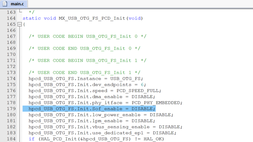

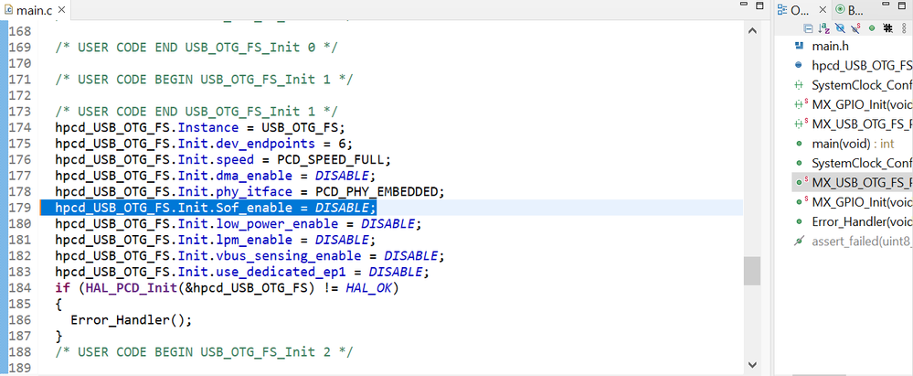

Hi @NRoth.1
I used your stm32cubeIDE version 1.10.1 and it works just fine
Ghofrane
