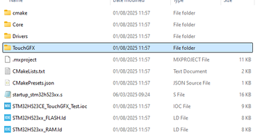

When the TouchGFX Graphics Application is selected, the supplementary TouchGFX code is generated; however, the TouchGFX library itself is not included in the project. I tried all available code generators, but none of them added the library.

Hello @peterdonchev ;
Could you give more details about the name of the missing files library.
When, I generated the code from your ioc file, I can see the TouchGFX library in the project.
Please try to use the latest version of X_CUBE_TOUCHGFX 4.25.0.
Thank you.
Kaouthar
2025-08-01 4:23 AM
This folder does not contain the actual library; it only includes generated supplementary files. The TouchGFX library is expected to be located in Middlewares\ST\touchgfx, but that folder is missing.
Regards,
Peter
